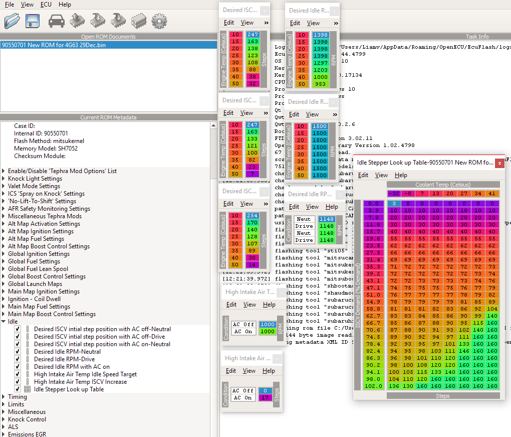

I've had a bit of a read through old posts, but it seems 90550701 is missing a bunch of the idle tables. ISCV demand adder? RPM recovery? I've seen a few tables mentioned that I dont have. I've attached a screenshot of my tables (they're in order top to bottom to match the list on the left hand side). Now I understand the solution is probably to adjust the steps values in one or more of these tables. the problem is I've got nothing to start with, I dont know whether I should be working in steps of 1 or 10 for example.. and it seems a bit counter intuitive to me, why is the initial position with AC on LESS than it is with AC off? (14 vs 32 steps).

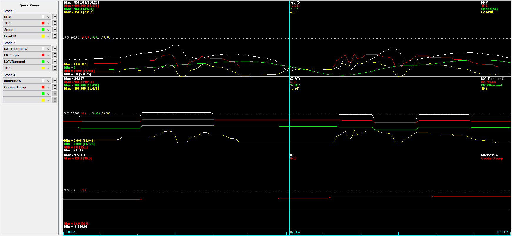

I've attached a recent datalog from a warm-ish (pretty much cold) start, you should be able to see the RPM fluctuations if you have a graphing software like megalog viewer. This is a clutch in stop with the AC on.
This is a stop with the AC Off. The RPMs dont fall as far.
