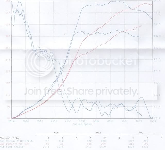

And you say the below dyno sheet, the lower torque curve is spring pressure 14 psi? Well peak torque occurs around peak boost. So according to the below plot you aren't making 14 psi until well after 4500 rpm much less 20 psi.
So your boost plot you posted and this dyno plot don't match up at all. Not even close.

that log was talken after the dyno tuning..
on that log 3rd gear i made 23 psi at 4571...
I can't explain the dyno chart, because I cant say when I hit full boost.. you assuming that full boost is full tq, but it maybe be + _ and we are only talking a few rpms 500... which on the road isn't ****.. 500 is so fast i can't say..
if anything i'd say my zeintronix is going to read faster than that dyno chart...
its right on what ams says on the spool time..
I also think that it depends when you go 100%tps what rpm,, which the two diagrams might of been different rpms.
not a big deal,, I'm happy with the spool,, yea at first i didn't like it cuz i was used to my green, but I adjusted my driving style until I build a motor....
would you want to roadcourse this turbo on a 2.0,, probably not.

Yeah I hear ya. I just try my best to have a sense of how responsive different setups are and I guess this 850r spools pretty well. I would have thought slower than a 35R but maybe a lot better. Anyway good luck and sorry about the inquisition.Originally Posted by FastAzzEvo
