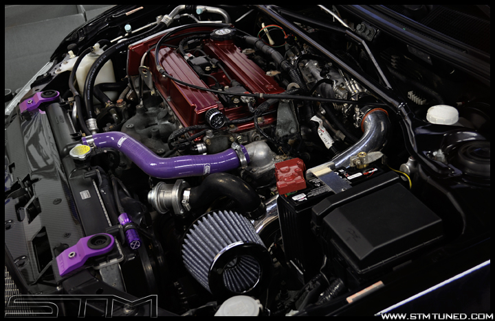

This is one of the first few Evo's to have AEM V2 installed.
Here's some quick specs on the car:
2004 SSL
Stock FMIC/lower pipe
23 psi falling off to 20 psi
STM Intake
STM Upper Intercooler Pipes
3" Turbo Back Exhaust
Stock 2005 turbo
Kelford 272's
AEM EMS Version 2
Stock injectors
Stock intake and exhaust manifolds

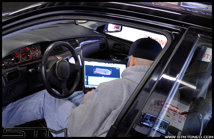

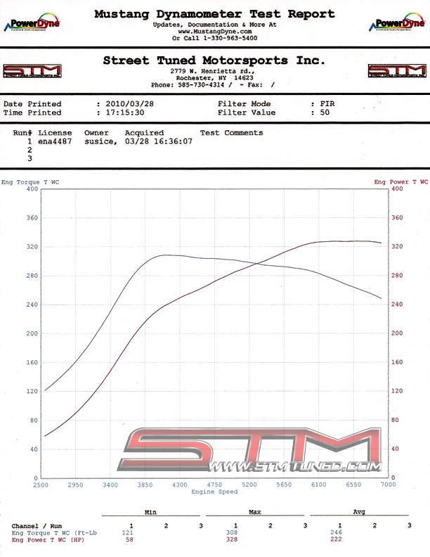

Just like Everyone else, I like it. While we were tuning it I decided to do another test as we were already there. The whole time Tuning the car we left the stock maf/filter setup installed. The last pull we removed the factory maf and started another test, Watching the wideband go leaner right away I knew we were looking at more power. IT picked up 5 whp all the way through and about 10 at 7k. Thats quite a bit with no tuning and running such low boost. That alone tells me SD is worth it. With more power/boost there would see a bit bigger difference. I know David did this test already and found even more power then we did, Im sure it was on a higher power car though.
As far as the system goes, It seems to work very well and once I got used to it, it was very easy to navigate. I'm sure there are still some bugs here and there but I think over time they will get worked out.

Depends on what you consider "overkill"? If I can gain more control with a stand alone, why not use it? The car seems to have made a lot more power on our dyno then any other Evo with similar mods running a stock ECU. Remember, Evo's on our dyno that make this kind of power go mid 11's.

I also think those are good numbers considering you have cams with STOCK injectors LICP and Intercooler! very nice.
