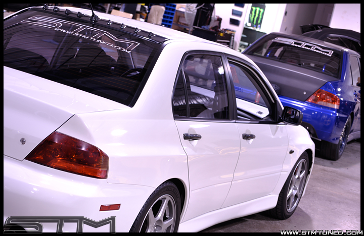

Sunday ended up being a crappy, rainy night and ruined our plans for a cruise. But while we were all at the shop, bored, and looking for something fun to do, we happened to have a 5 gallon pail full of fresh E85 and a white Evo RS begging to drink it!
So on the dyno she went! Staying with the exact same set up as the 93 octane tune (which previously made 413 HP and 333 TQ) Emery worked his magic and pulled out 446 HP and 383 TQ, gaining 33 HP and 50 TQ... and there is definitely room to go up, but the 1050cc injectors are just maxed out at 110% duty cycle.
Maybe some bigger injectors and a double pumper might put this car a little closer to that sweet 500 stock block spot.
