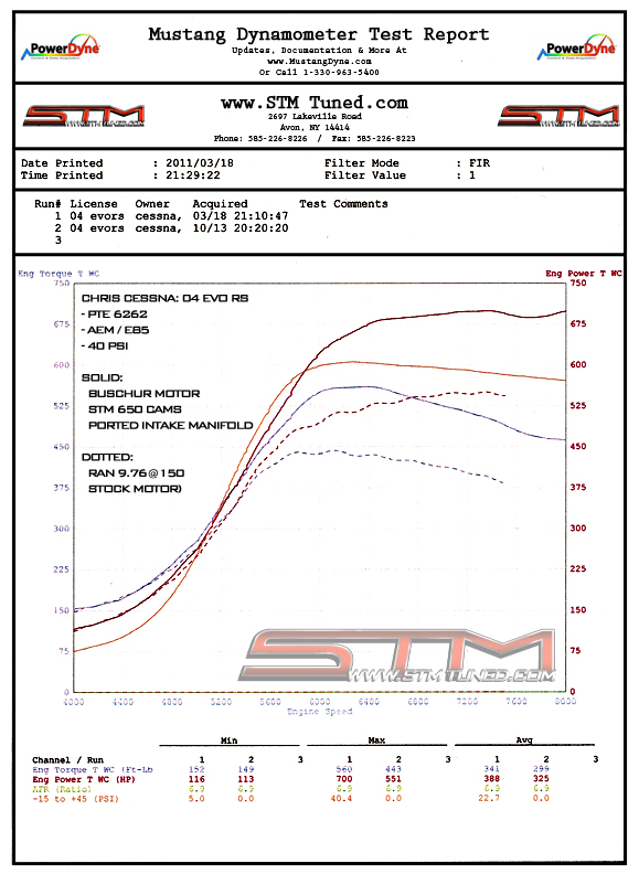

Earplugs were very necessary. We will have a video of the pulls up a bit later, but 700 is no joke! The dyno graph compares his tune now (solid) to when it ran 9.76@150 on the stock motor (dotted).
+149 HP
+117 TQ

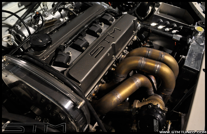

New additions since:
- Buschur 2.0 LR
- STM 650 Cams
- STM Ported head with .5mm Oversized Valves
- STM Ported Stock Intake Manifold
- STM Catchcan
At 40 psi with what we suspect to be an old blend of E70. Haven't tested it yet.

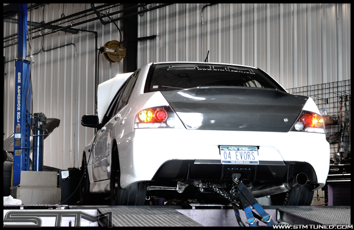

I'm probably out of the loop but since when did they offer a doluck ducktail trunk for the 8/9?

A different manifold may be something we look at some day. As for right now the turbo is simply out of steam. It will not hold more than 35 psi at 8500.
We reved this car to 9k on the dyno where it actually makes a little more whp but the tests were set to stop at 8k so that is all the sheet will show.

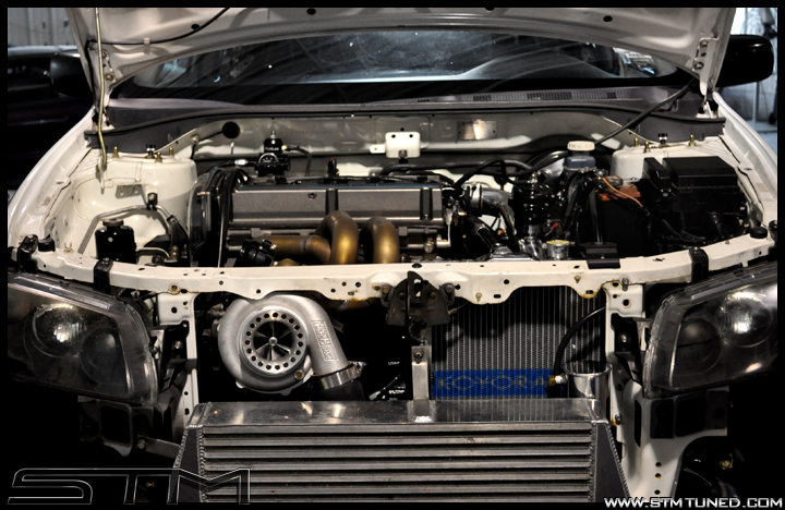

Is the 6262 used ball bearing?
Old Mar 18, 2011 | 01:51 PM
EmeryatSTM's Avatar
iTrader: (79)
Posts: 2,340
From: Rochester, NY
Yes.

I noticed that nice catch can setup where the ACD stuff is. You going to make a kit for this?
