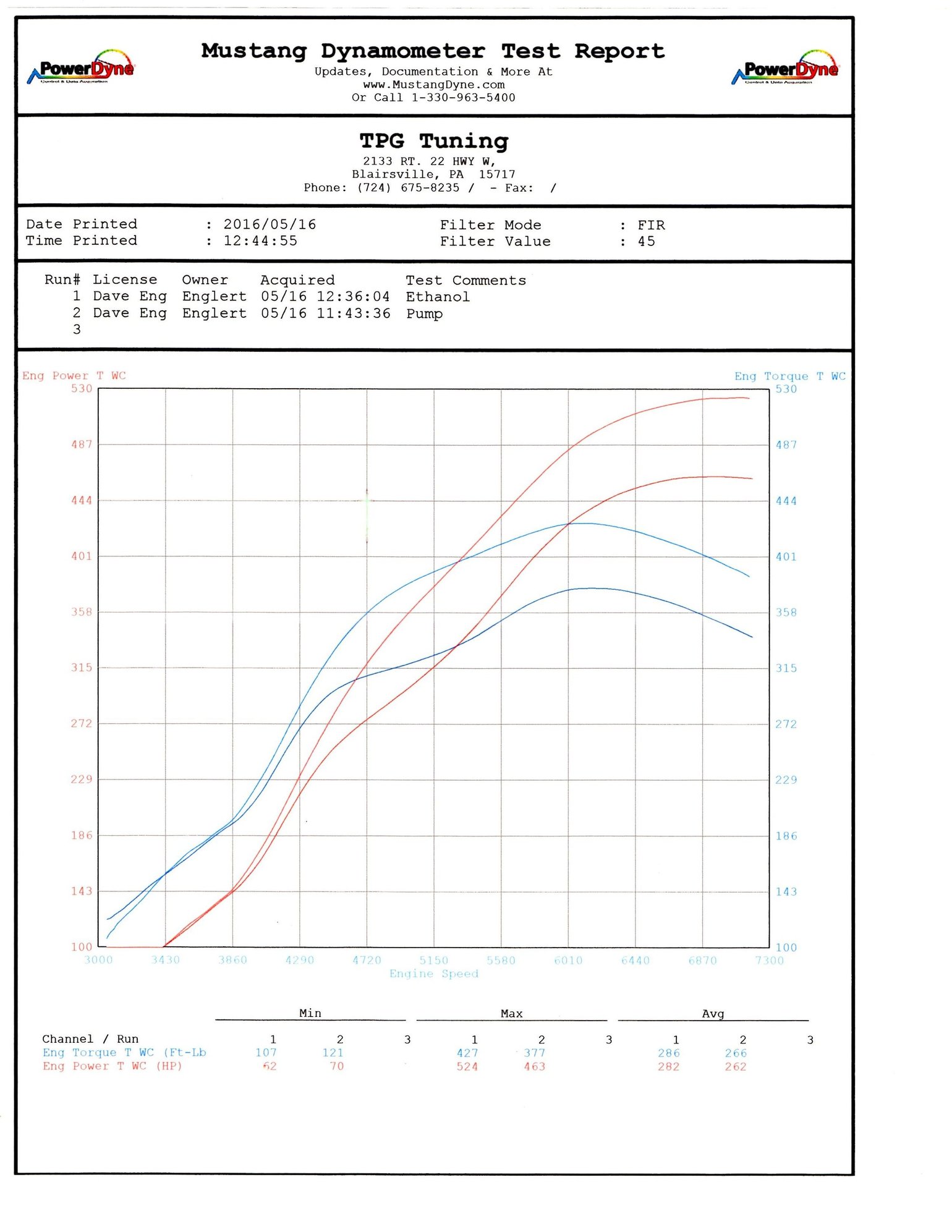

Car is on 3dsd, running 2 maps with a Buschur supplied map switch mounted in the glove box.
Car was previously tuned at 409whp by Tpg Tuning outside of Pittsburgh, Pa. They also tuned it this time.
Jason at Tpg had no problem making power with the car, however had some hiccups with the drivability. He was relentless in getting the car perfect. I had replaced the pcv with a different check valve for the catch can setup I was running, and the car didn't like it. We went back to stock pcv, and it idles and drives like stock, except for it's louder and faster!
Tpg has great guys on staff, and I'm a very satisfied customer. Jason, part owner, went out of his way. They charged me once for my tune, and didn't quit until they nailed it.
Dyno graph on e85 is from the first ethanol pull. Car surprised him, lol. It was dialed back to 511whp and 409wtq. Pump gas was left as in on the graph. <br >

nice #'s what was the boost level for both fuels?

31 and 29. It holds 26 for a little bit on ethanol to keep the torque around 400, then hits hard around 6k. I didn't think to ask for the boost plot, but I probably will now.

Id like to see the boost curve. When do you see full spool by?
What kind of timing are you running?
Good results, overall.

Full spool is different on ethanol, since it's limited for torque. 4kish. I'm not a tuner, so no idea on timing, lol.

I definitely agree with it just being a number, especially when it's not a dynojet. Typically, from what I hear, this dyno reads a little higher than Buschurs' dyno, that's why I asked. Plus, it's about 2 hours away.

Mustang dyno's can be adjusted . If they have the same firmware they should be pretty close.
Typically heavier weight OR less correction makes them read higher from what I've seen.
A local mustang dyno is close to a dynojet at 3300lbs and 15.3 settings FWIW.
Any idea what the settings were? Does it make power to 8000?

No idea on the dyno settings. The car pulls strong all the way to 8k. Put it this way, I took it to a local flashlight drags last weekend. It's basically street racing at an airport. It pulls so linearly, that you have to pay attention to the tach, since it's still pulling into redline. The car is a lot of fun. That was on pump gas too.
