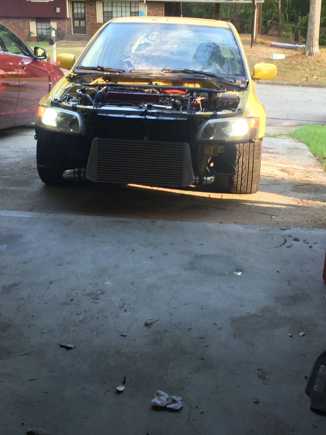

Yep, I forgot the size of it..
9:5.1 Wiseco Stroker pistons w/ upgraded wrist pin, o-ringed block, arp 625 head studs, TT 156mm Rods w/ arp 625 rod bolts, GSC race shaft, GSC full valvetrain w/ GSC R2 billet cams, ported cylinder head, ported intake manifold, speed density setup, 65mm TB, fluidamper pulley, FIC 2150, cam gears, etc.
Built 2.4lr currently on stock frame FP Black

Very nice, looking forward to your results. It may just surprise the 'turbo traditionalists'...
