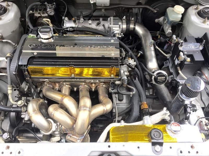

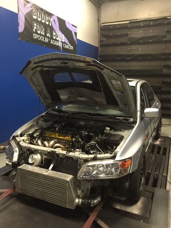

Evo 8 2.0L FobiaFab FF 6466 E85 42psi
Mods:
2.0 (Manley Turbo Tuff Rods and Wiseco HD Pistons) built by DB Performance
Stock ported head w/ MAP Beehive Springs w/titanium retainers
Buschur 272s
Kiggly HLA
Buschur upper ic piping with turbosmart race port 50mm bov
Fobia Fab lower intercooler piping
Spoolin Up Cop
Fobia Fab front facing manifold
Turbosmart Hyper Gate 45HP Wastegate
PTE T3 Gen2 6466 .82
Buschur 4" FMIC
Curt Brown extreme port IM with 70mm S90 TB
FIC 2150's
Dual Walbro 450's
Turbosmart Fuel Pressure Regulator
AEM EMS V1
Quartermaster 8leg Clutch
Jacks stage 1 transmission and transfer case
E85

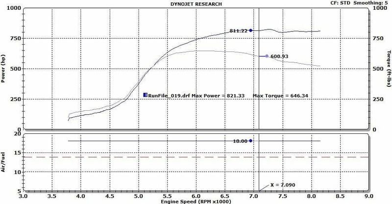

nice numbers!

Nice numbers!
Love the exhaust exit!!!!
What happened with the a/f?

A/F is fine. Not really sure why it read it like that on the dyno chart.
