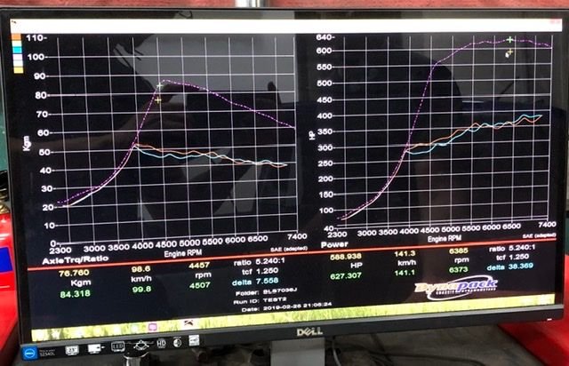

Can’t get past 320whp on FP54
Hi everyone. It’s my first time posting so I apologize if I am in the wrong section. Please go easy on me.
Was hoping to get some input as to why why I am unable to make power on my Evo 9.
Build:
Stock 2.0 engine w/ Gsc cams
SARD Fuel regulator
FP54 green BB turbo w/ 84mm compressor housing
FP exhaust manifold
HKS turbo elbow and downpipe
HKS intercooler w/ Synapse DV recirc
HKS intake with MAF
Walbro fuel pump 255
DW 1000cc injectors
Spoolin up COP Coils
Ralliart ecu
Stock intake manifold
Stock throttle body
Test pipe
Trust titanium catback 2.75 inch
SARD radiator
I have been through 3 tunes and each time tuner was unable to make any power past 320WHP. Car would start detonating and stop making power once boost was turned up past 1.5bar(approx 21psi). Even after timing was adjusted. His initial diagnosis was back pressure issues. I have since done a full swap of my exhaust system, checked for leaks(boost and exhaust), swapped out many parts and am still experiencing the same issue. We are both cracking our heads as to why the car won’t make power.
The same tuner was able to tune several other Evos with 71hta (380whp) and a fp green JB (500+whp)
The purple line is an Evo 9 with a built 2.3 stroker and fp green JB with almost identical bolt ons as me tuned by the same tuner. My line is the light blue one.
Any help would be greatly appreciated. I am at my wits end trying to figure this out. A lot of money and time has been spent on parts and tuning trying to troubleshoot this issue.

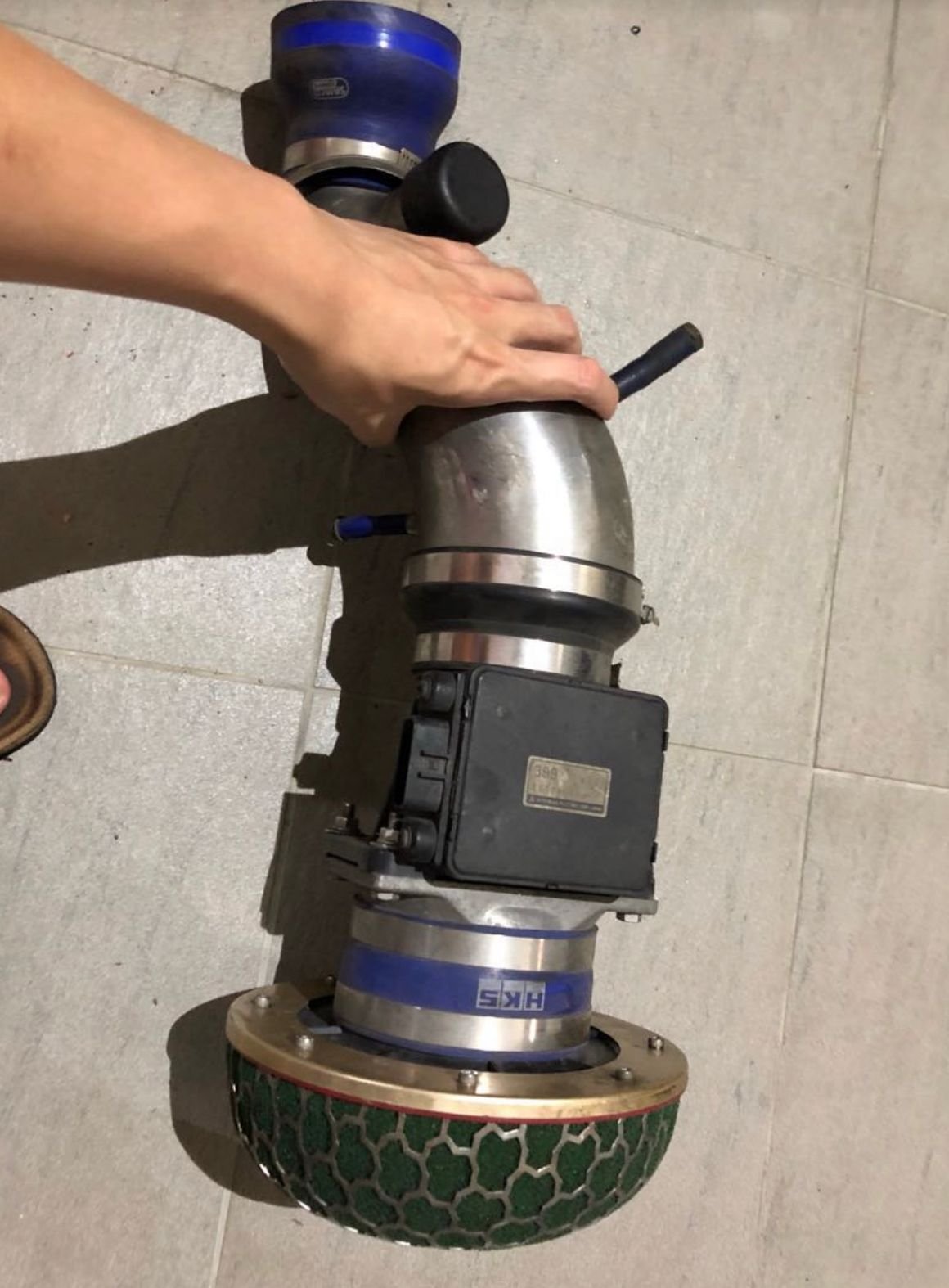

Also, I have just installed a FP intake to properly match the 84mm compressor cover - post tuning. Car feels more responsive and partial throttle flutter has completely vanished. I know it’s a long shot but I was wondering if my old intake setup might be the cause of my issue due to the uneven diameters of the pipe/silicone reducer. Have attached a photo of my old intake setup (photo was ripped off the net but is identical to mine)
I ran the same hks intake setup as yours with a maf before I went speed density with a old school fp green turbo spraying meth at 30 pounds of boost and would make 400 whp dynojet, so I would say it’s something else.
