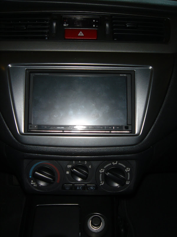

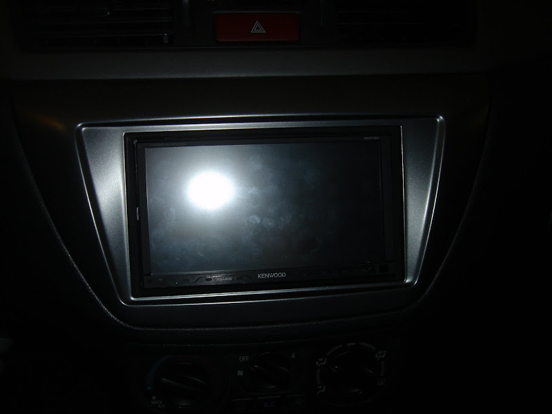

Old Oct 30, 2008 | 02:51 PM
truDriver's Avatar
Joined: Jan 2007
Posts: 514
From: SC
Originally Posted by diegoalunan
update on the finished product pls
Sorry for the crappy pics. Overall, I'm really happy with the results.
