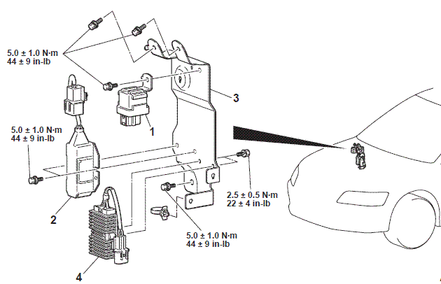

Take a look at the resistor pack mounted to the firewall. Its an rectangular box of aluminum about 4 inches tall and about 1.5 inches wide with a pack 5 wires coming out of the top. The top is open so you can see the 4 big, white resistors and there is a problem with the leads on the resistors rusting out right where the wire attaches to the resistor. You can try touching the leads on each of the four resistors (the 5th wire runs down between the resistors to the bottom of the pack) - if a lead wiggles, it's probably rusted out and not making contact anymore.
I had it happen on a friend's '03 and on my own. The piece is pretty easy to replace (two 10mm bolts and unplug the wire harness), but it's kinda pricey ($70-80?).

That's a possibility for yours, nick2shyy. But navysandsquid said he changed injectors already.
Either way, not a bad idea to at least inspect that resistor pack - only tool you might need to inspect it is a flashlight.
I've attached a pic from the service manual showing the assembly. The resistor pack is #2 in the pic.

Sweet! thank you very much. I'll take a look at that tonight. If it is not that, I need to find someone who wants to sell a set of stock injectors now

Alright, I figured it out and it is that resistor pack connector. Does anyone know how to go about replacing this? Or the part number I order from mitsubishi?
