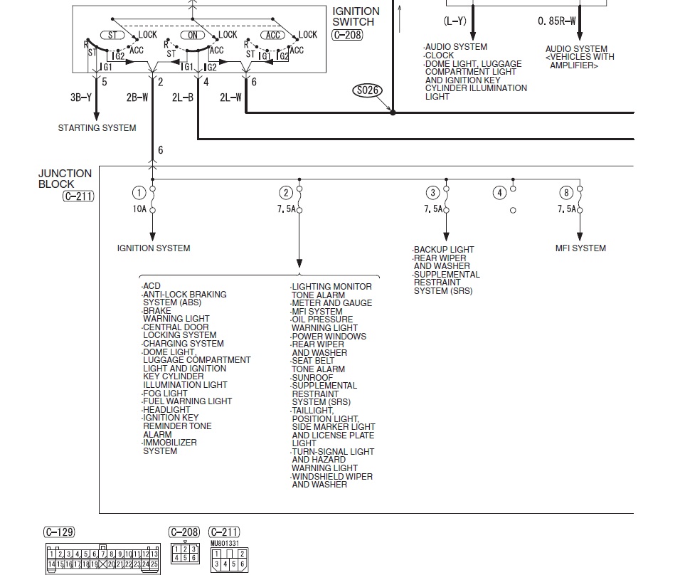

well, because the aem gauges zero everytime you turn on the ignition, they require a source of power that will stay on during the cranking of the motor. otherwise, since the power source is switched with the ignition and turns off during cranking, it will try to zero again after power is restored. only problem is the motor is running, which means that the gauge is zeroing with an incoming signal, making the gauge read wrong.
Old Mar 18, 2013 | 11:48 AM
nollij's Avatar
iTrader: (21)
Joined: Feb 2010
Posts: 747
Likes: 9
From: Rural Northwest
Everything fed from IG1 in this picture. You even have a free open spot!
