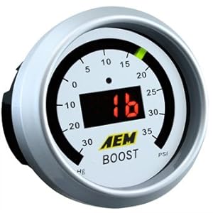

[SIZE="3"]Having owned both gauges and seeing ALOT of posts asking what is better and what to buy, I decided I would post this thread.
The two gauges I am comparing are, the prosport Vac/Boost EVO SERIES and the AEM Boost display gauge.
When talking about each gauge I will use BLUE font for PROSPORT and RED font for AEM
First off some quick specs to compare
- Prosport EVO series Boost gauge is priced at $85.00
- AEM Boost display gauge is priced at $168.25
- Both the Prosport and the AEM are -30 Vaccum and +35 Boost
- Prosport is a full digital display and the values are all an image that changes
- AEM has individual LED lights for the sweep display and a display for the numerical value.
- Prosport has a - for vaccum while AEM doesnt.

Out of the box this gauge is much nicer, first off it is packaged nicer in its own kind of display. The wires are pretty thick and insulated to keep them nice and neat. The boost sensor is nice and heavy, most likely made of brass, and you can feel the quality difference.

Installation is easier than the prosport, You have power and ground for the gauge and the wires for the boost sensor are already provided and splice off from the harness.

The display on the AEM is very simple, and very easy to read. During the day or at night it reads great (the gauge has a self dimming feature which makes it very easy to read day or night). The AEM when boosting is going to be a bit quicker than the prosport the sensor to me seems very sensitive. The display is nice and big makes it super easy to glance at it and get a reading. This is more of a simple gauge while the prosport will be a bit flashy.
Overall, both are nice gauges. I first had my prosport and liked it, but the quality difference between the two is like night and day. You get what you pay for. I had my prosport for almost 2 years, and had to rewire the ground cable for my boost sensor Multiple times, to the point where I ran out of length, thats why I bought the AEM. I highly recommend saving some money up and buying the AEM over the prosport. But if you want a cheap gauge with cheap parts and dont mind having to replace some, go with the prosport.
