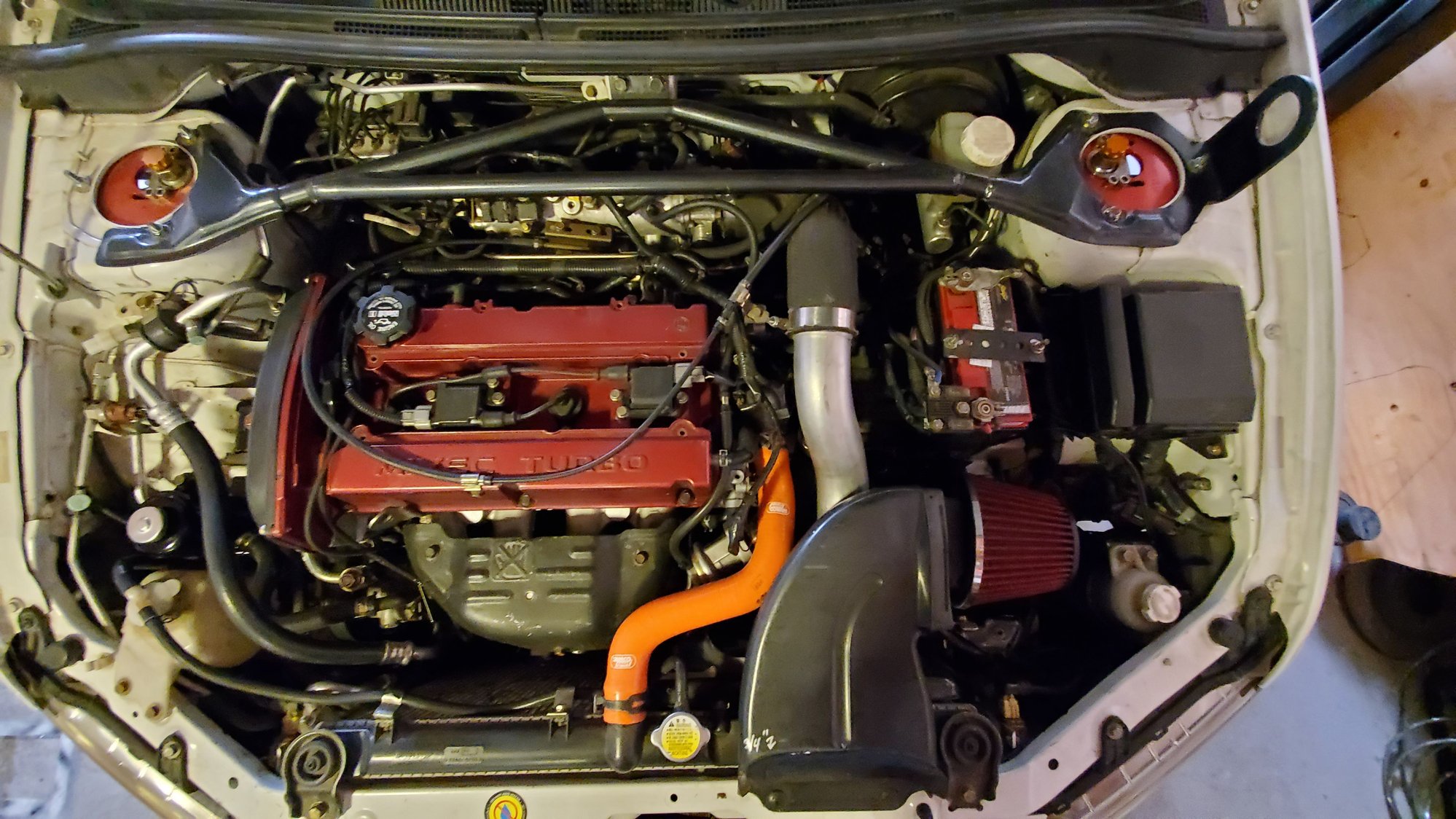

So I went to Ballade Sport on Saturday with my stock battery and it turns out the FK8 ctr battery is the exact same size, even had the handle and everything. If anyone is in the market for a lighter lithium ion battery then check out the ones at Ballade sport. I'm not affiliated with them at all I don't get a cut on how many they sell I'm just trying to help out the community. They also offer a smaller s2000 sized battery at 9lbs but I didn't want to have to mod anything with the tray. With the FK8 ctr battery I shed 17lbs just by switching batteries, take a look at the pictures. I'm pretty sure it's an antigravity clone just doesn't have the emergency start feature, the lil led light up top shows either how much the battery is charged or the voltage.
