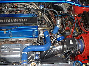

All I needed was 3 - 2.5" Mandrel U Bends, 3" of 1.5" and about 1 foot of 2.5" straight pipe. It took about 4 hours and I have around 30$ in to it! I will post pictures of my install after the paint dries.
Tell me what you think!

Well I personlly made this pipe to fit without a battery in the front and a different BOV and dejontool intake pipe. I'm sure that I could fab a couple more, just have to order the stuff to do it. Any ideas on what I could charge?

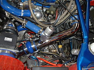

Here's the ones I did. 304SS, straight shot (battery under passenger seat).

Pic of pipes installed

I put some polishing wheels on my bench grinder.

another shot from top. The BOV pipe coming out of the top is the exact OD as the ID of my Turboxs H34 BOV, it bolts directly to the pipe.
Those pipes look tite, nice job man .

man why do you have to show me up!! Very very nice! Makes me wish I would have used stainless.
