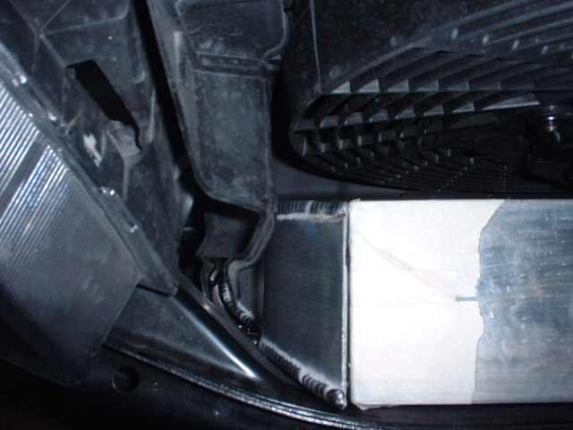

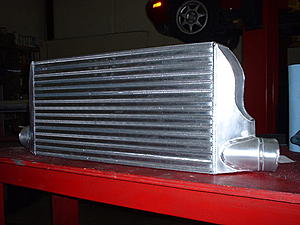

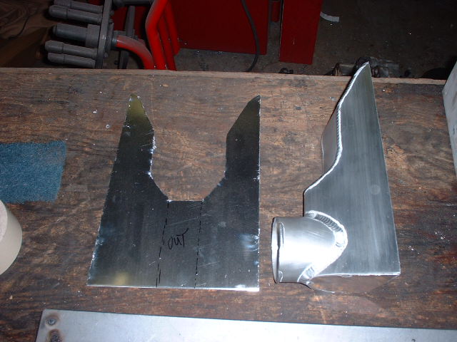

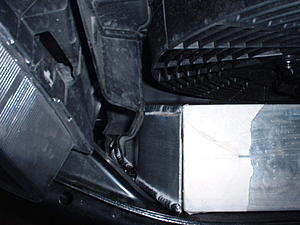

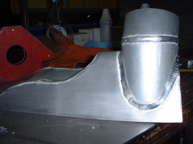

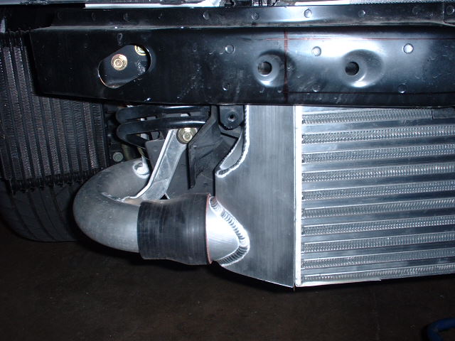

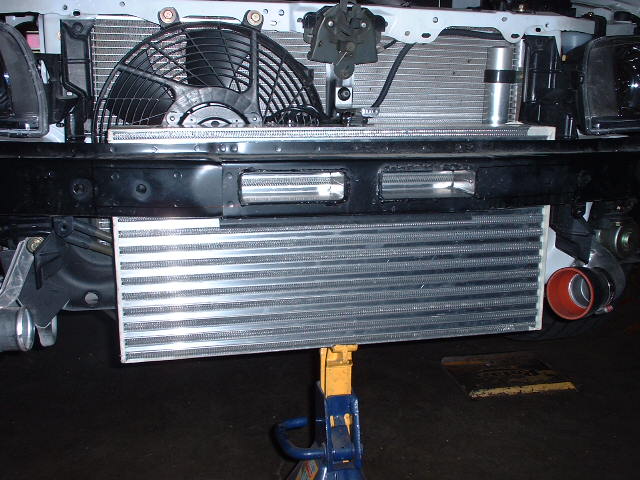

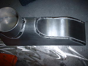

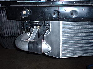

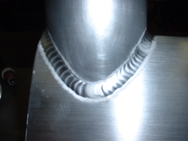

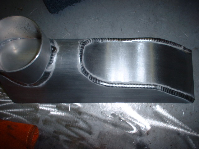

Here are a few pics of an Evo intercooler I'm building at work. It's a Garrett core(24"x12"x3.5") that just barely fits. Intercooler was designed to work with the stock plumbing although a larger lower pipe is in the works.

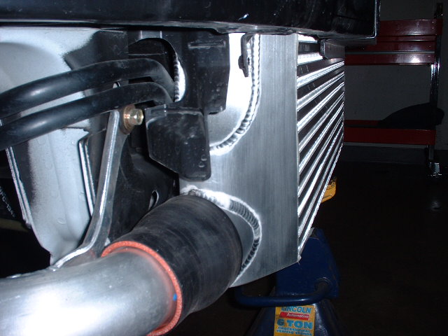

A few more
Attached Thumbnails Intercooler project-testfitside.jpg   Intercooler project-supertight.jpg   Intercooler project-drivertnkclose.jpg   Intercooler project-icdonedriver.jpg

ooo shiny metal (sticking from the bumper)...lol...nice work man..and gud luck...damn i wish i could build parts for my ride at work
post pics when fully finished...curious 2 see it finished

Nice work, welds look super clean

what Tig are you using , looks very nice
I'm using a Lincoln Square Wave 275. It welds like buttah! Thanks for the replies. I hope to have this thing finished this evening.
