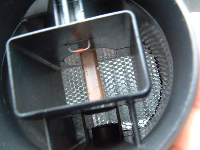

ok, got the maf sensor off. whole thing is covered in oil and dirt spots.
I got the q-tip and try to clean it up a bit.
Now, the unusual thing I saw on my car is that the bottom honey comb is gone.
I did get the car used and this is the first time i'm looking at my maf sensor.
I read it somewhere from RRE website about doing the taking the bottom honey comb out... for something I can't remember...
i don't know if that's doing something to my a/f ratio.
I'm trying to find the link now.
pix:

... ok, correction, that little wire coming out from the top? that might be the hotwire.
The little brown thing in the middle? right below that is the pressure directing hole.
I don't know where the hell the vortex generator is... it maybe just the honeycomb that generates Vortex.
So, why the hell do we have a hotwire on the back of the brown pressure directing pipe?
***ing jebus...

Dunno what this has to do with anything... but when I bought my car used, the previous owner had the car tuned with the UTEC. The UTEC tuner stripped off the silicone on the bottom of the MAF and adjusted the screw. Unfortuneantely, I have no idea how far the screw's current calibration deviates from the stock calibration... but I'm assuming this messes with your air/fuel ratio a good bit. Might wanna check and see if your calibration screw was adjusted too.
***ing jebus...
From the picture you posted, that "U" shaped wire at the top is the IAT (Intake Air Temperature) sensor. Is that what you're referring to?
Definitely take some time to clean your MAF. Pop it out and spray some Electrical Parts Cleaner on it. Let it dry for 10-15 minutes. Repeat if so desired. Just make sure that bad boy is dry before you start it back up again. And don't smoke while you're cleaning it. It's flammable as hell.

you're right. I just looked at the diagram again, that's the intake air temperature sensor.
So, the dealer was wrong.
anyway, from what I've researched, electric cleaner shouldn't be sprayed onto the Karman type maf sensor. That's not recommended.... ?
and C, that screw... you're right, they have that mod for the 2g and evo maf sensors... damn... maybe I need to take my shlt back up again...

If it's any consolation, when I had my 350Z I went through a similar situation. I installed a popcharger and the oil from the filter fouled my MAF. I cleaned my MAF with the same method. The only discernable difference I can see between the Z and Evo MAF is the honeycomb structure in front of the hotwire. I used the cleaner that was formulated especially for circuit boards. Since it's your car, it's your call obviously. But I would recommend it.

we don't have hotwire maf sensor. We have karman vortex type maf.

well, see the bottom screw mod?
do any of you have the picture of your maf sensor?
I want to see how high that screw is from the pressure directing hole (right below brown thing).
