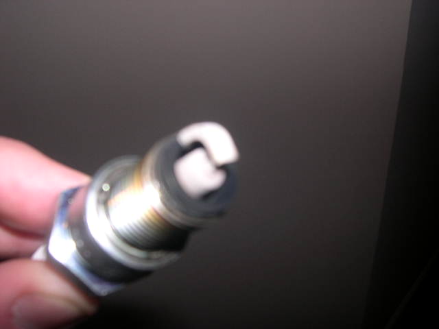

Spark plugs have the same white on them as the turbo hotside. pics below. I don't see any red though.
I did use xylene in large amounts, about a gallon of xylene for every full tank of premium gas. Plus a little Mystery Oil additive (fuel lubricant/detergent), probably a couple tablespoons worth.
So i guess its just the xylene that caused the white color.
Attached Thumbnails White hotside-spark-plug.jpg   White hotside-spark-plugs.jpg

ok, that means you're running very lean.
what do you have as mod? and are you tuned?
i don't think xylene could cause that color on spark plugs.

you might need a fuel pump.
That exact thing happened to me before.
http://*********************/forums/showthread.php?t=228 for cheap fuel pump.
you do need to change the spark plugs, run couple of wot runs, then take your plugs out to see if it still does it.
If it still does, that means most likely your fuel pump isn't working properly or you're running lean, aroudn 12.3 aft range for that slightly brown tint white on the spark plug tip.

I installed some NGK plugs about 1000 miles ago, I'll go check them out and see what they look like. The plugs in the pics above were the stockers after 17k miles.

ur running lleeeeeeeeeeeeeeeeeaaaaaaaaaaaaaaannn.(Lean)

i want you to compare my plugs when i was running hella lean to yours.

well, your timing line is right, color is right.
i guess it's the xylene... unless you did some tuning before you change the plugs.
I don't see the additive could cause that though.
