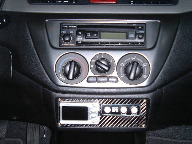

Here are some pics I took tonight after the install.
This is where I put the controller
Here is a sideshot
This is my view from the driving position
The last pic is a night pic...
comments welcome

I have the same controller. I put my controller in my glove compartment though and mounted the screen down by the ashtray. I wouldn't mind trying putting mine where you did though.

I used double sided velcro tape to mount the screen there... I can monitor my boost in PSI with the HKS and Bar with the Blitz TT
