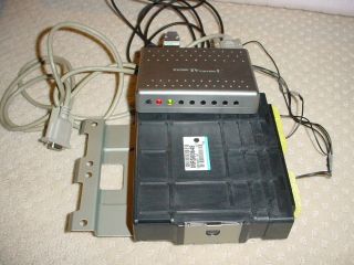

I the case of EVO serise,
After Evo5 can be reprogram with some special interface of PC
and MMC's special Protocol.
in japan, sell interface like attached image.
One make only available flash ~Evo 6 and 6.5 (Tommi's)
Other one sell to ~EVO8.
i have problems understanding what you are trying to say on your post.
Originally posted by Takashi i have problems understanding what you are trying to say on your post.
