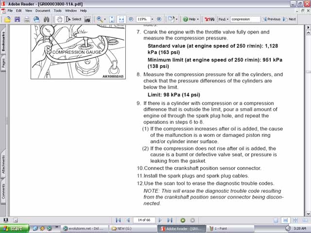

This pics may help. These are straight from the 2003 service manual.
Attached Thumbnails Did a compression test ~117psi after 720mi-1.jpg   Did a compression test ~117psi after 720mi-2.jpg
