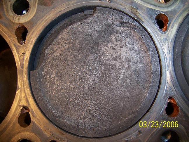

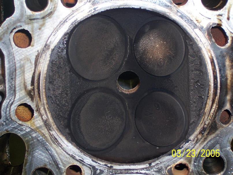

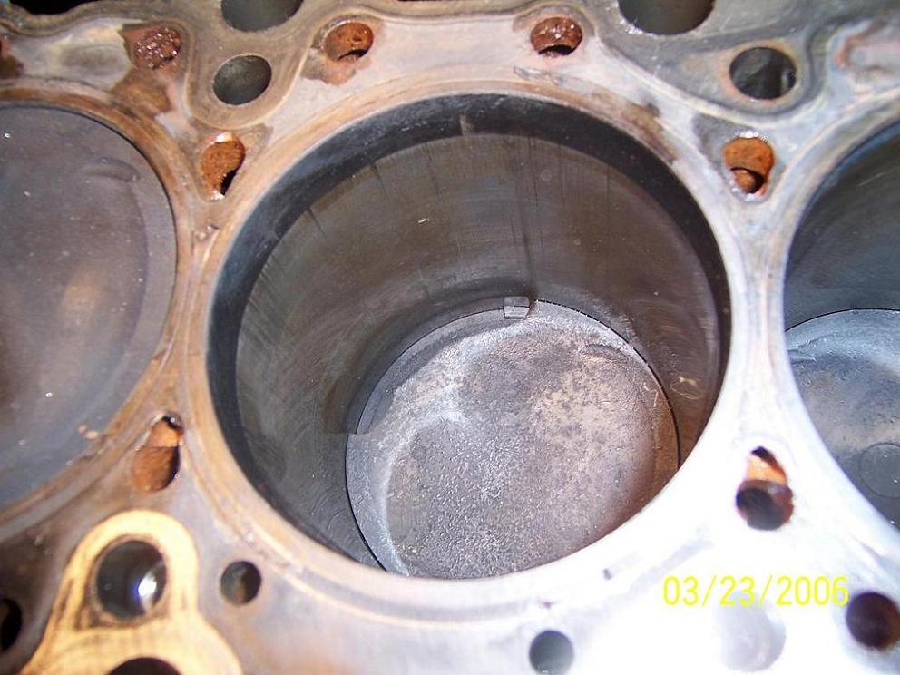

Well the time has come to build the motor in the Evo. I have had low compression in the #2 cylinder for about 2 years now and it has been pushing coolent back through the radiator cap when I would race it. But under normal driving it wouldnt lose any coolent. I have driven the car to Florida 3 times and Ohio once. Well this is what I found when I pulled the head off. I have also been driving it everyday up until the time I pulled the head off. I cant believe it ran as well as it did when I found what I did to the ring lan...
