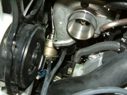

I'm gunna post a picture just so you don't think I'm crazy, If the nipple is on the LICP then why does buschur sell their LICP without the nipple? I mean I have the horsepower freaks LICP and it has no nipple, yet I still have my nipple for my MBC to hook up by the turbo, and NO I am not using the nipple on the MAF pipe. I have mine hooked up fine and it works great, I just can't believe how many people out here have no clue, any way here is a pic I found of the nipple that I use as the source to my MBC...
Old Jul 2, 2006 | 07:05 AM
  #45
dan628's Avatar
Posts: 802
From: Sycamore, IL
Ok here is another picture too... the hose on the left coming from the wastegate actuator, and the hose on the right, the turbo nipple!
