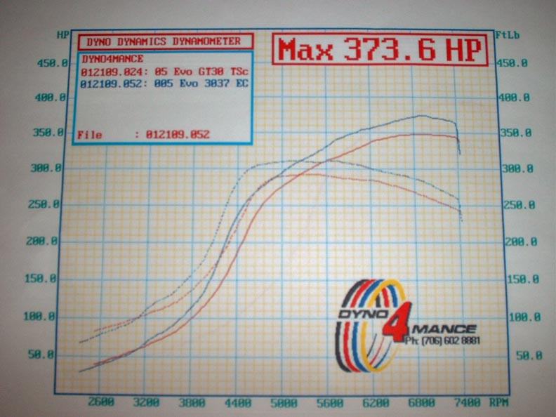

Went over to Dyno4mance Sat. to dial in the new cams and man was I impressed with the results. First pull without any dyno tuning netted huge gains from low to mid with 50lb/ft gains in the 4-4.5k regions and 40whp with a slight gain at peak. Power improvements started as early as 3.2k. These cams spool up the turbo much faster than my previous,272i/264e, set up. After dialing everything in and turning the boost up one psi to 23 I ended up with 25 more peak whp and 60more lb/ft and 50 more whp in the 4-4.5k ranges. Power was increased from 3.2k to redline. These cams rock!!
Thanks to Adrew at Dyno4mance for helping me get everything right. I have been tuning this thing myself with ECUFlash, but Andrew came through with some very good suggestions which netted great power improvements and a solid curve. We had to stop as there was another customer waiting to get on the dyno and honestly I think we could get maybe another 10 out of it on 93, but for now I very pleased.

Was your tune on your previous cams your own tuning and the tune on these done by Andrew? Im just wondering how much of the gain is cause of the cams or the tune. Very nice gains though. Im thinking about doing some more aggressive cams and were looking at the GSC 280's but might have to look at these as well.

I do all my own tuning. Answer to your question lies in the first post.
Thats what I was referring to. I was just curious as to how much his additional help may have been alittle factor. Not knocking your tuning ability or anything.

I didn't take it that way, just that the first few lines of the post talk about the power before doing any tuning. I don't have the cam card in front of me, but you can see the spec at Forced Performances website.

Can you overlay the graphs

Graph at the top is an overlay of the previous best (red) vs. new best (blue).
