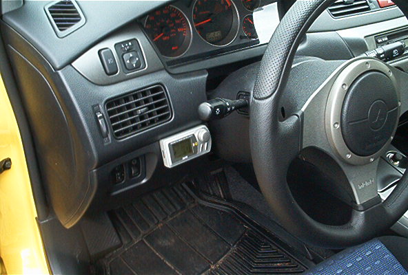

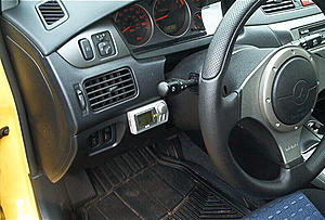

here's a pic of my cheezy mounting

That actually doesn't look too bad. It stands out but doesn't look bad. You "moved" the stock solenoid to where? Doesn't the new solenoid replace it or do you keep both installed?
