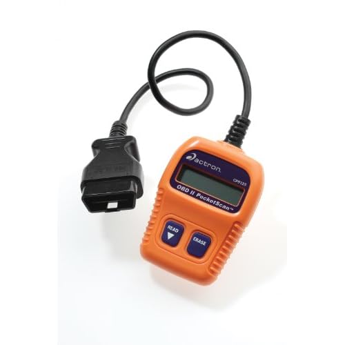

A reflash didn't fix my car so I installed a Creader. End of story.

Works wonders (I have it)
Available at Amazon.com for $60 plus tax
