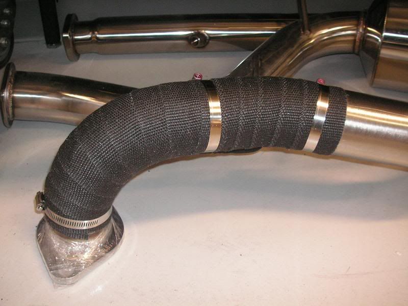

CBRD's Avatar
iTrader: (60)
Joined: Dec 2004
Posts: 7,363
Likes: 8
From: york, pa 17402
looks nice like this...
