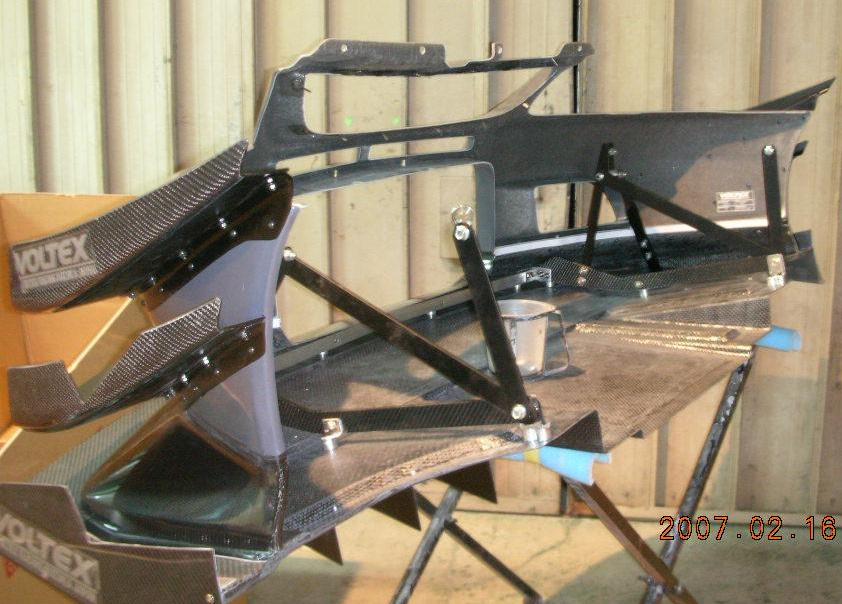

voltex assembled

From: Maryland,N.Carolina, New York
Nice...
Is that yours?
Im going to use that as a reference for my front diffuser support/ mounting

Originally Posted by trinydex
voltex assembled
Looks like you have to be careful which way the car points into the wind when you park it.

none of this is mine... it's all for the benefit and information of everyone in the world.
i am making my own front undertray. i just don't know if i want to make a lip or not. i'm running the cwest and my ride height is pretty high. i still scrape on some things, some shopping driveways etc.
a lip will generate a lot of downfoce but the problem is clearence and also that i'd like to make my undertray out of the thinnest possible material. that will induce both more labor and some basic materials problems to reinforce only the lip by say adding/doubling the thickness of the lip's sheet metal.
the only other alternative is to make the entire thing out of thick gauge sheet and i dont find that to be a good option at all
the main goal of my project is to hold the bumper up so i can add serious canards and not peel the bumper off... adding a lip would be secure too but hte lip is proving to be an engineering headache.
