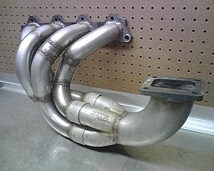

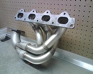

Old Jun 21, 2007 | 10:54 AM
evolution31's Avatar
Posts: 99
From: Miami
Just a few more of the header.

Old Jun 21, 2007 | 10:56 AM
TeStUdO's Avatar
Joined: Jun 2005
Posts: 1,986
Likes: 41
From: Secret Tweaker Pad
So who made that top mount exhaust manifold?

Old Jun 21, 2007 | 11:13 AM
Posts: 99
From: Miami
top Mount
Big Al from BMF Racing out of Miami!!!!
OHHHHHHHHHHHH! I thought you were talking about Al (DynoFlash) I was thinking to myself "When the hell did Al start doing fab work?"
