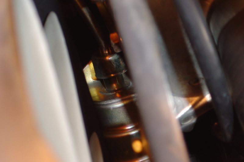

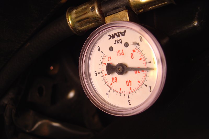

I completed the assembly of my boost leak tester and finally got around to testing earlier this evening. I first isolated the intercooler section by plugging the outlet pipe that goes into the UICP; it is here that I noticed some weird results.
The system held boost well; the only slight leak that I could hear was coming from my boost leak tester. The leak only amounted to ~2-3psi over ~5 min. The MBC was connected between the turbo outlet and the WGA and exhibited no audible leaks. I then noticed that the wastegate arm was extended at the ~15psi level where I stopped. I then depressurized and turned the MBC to its highest setting; I stopped at less than ~20psi and the wastegate arm was extended. Repeating a third time, I noticed that the wastegate arm began to extend at ~12psi.
The MBC is connected correctly: the line from the turbo outlet is going into the bottom of the MBC (farthest from the knob), the line to the wastegate is comming from the top of the MBC (closest to knob). The only spring that it came with is in the body of the MBC. Is my MBC not holding any pressure? Is it a defective piece, or could this be rectified with a rebuild? It is new with my BR stage 1 kit that I received less than two weeks ago. What does this mean?
Attachment 109227
Attachment 109228
