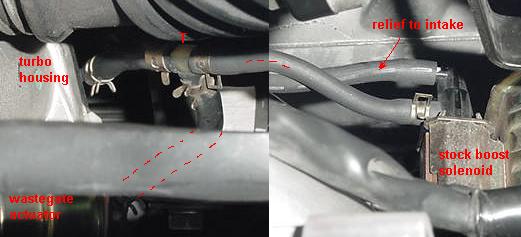

Old Dec 3, 2003 | 07:11 AM
  #75
sevensign's Avatar
Posts: 71
From: Brunei
I've been wondering where the restrictor actually situated, pinch the line on both side, can't figure where its at
