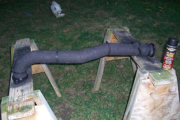

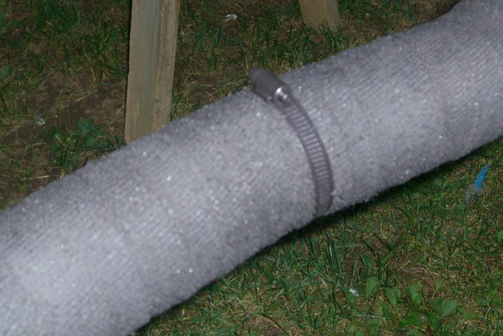

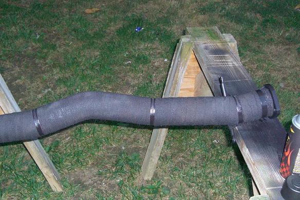

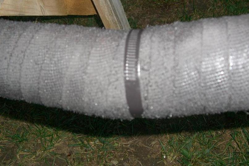

I just finished wrapping mine last night... I did the exact same thing....I got thermo wrap 2 x 50 and kinda just took it and wraped it around the DP to see how much I need as a estimate and once you get to the end of the DP make sure you wrap it 8 extra times (this is just incase you don't come up short on your DP when wrapping it) and the kinda just soaked it in bucket of water to soften it up enough to get a tight wrap.. and when done...let it sit in the sun for about a day to harden up and when its dry spray it with DEI silicone spray....I used about 2 can and let it dry over night and it was good to go....I'm at work but I plan to post pics up when i get home. It looks great!

To wrap my downpipe it took about 45 minutes...Now money wise...you may be right...I spend about $7 on the claps, $35 on the wrap, and $20 on the 2 cans of DEI silicone spray...Maybe your right bout cost wise but I thought we we're discussing which would do the job better?...but I guess they go hand and hand since it might not be a huge difference between wrap and spray.
Old Oct 15, 2008 | 03:55 PM
  #43
STIKiller4G63's Avatar
Joined: Jan 2008
Posts: 217
From: Every where
Here you go
Attached Thumbnails To Wrap the Downpipe or Not?-80.jpg   To Wrap the Downpipe or Not?-81.jpg   To Wrap the Downpipe or Not?-82.jpg   To Wrap the Downpipe or Not?-83.jpg
