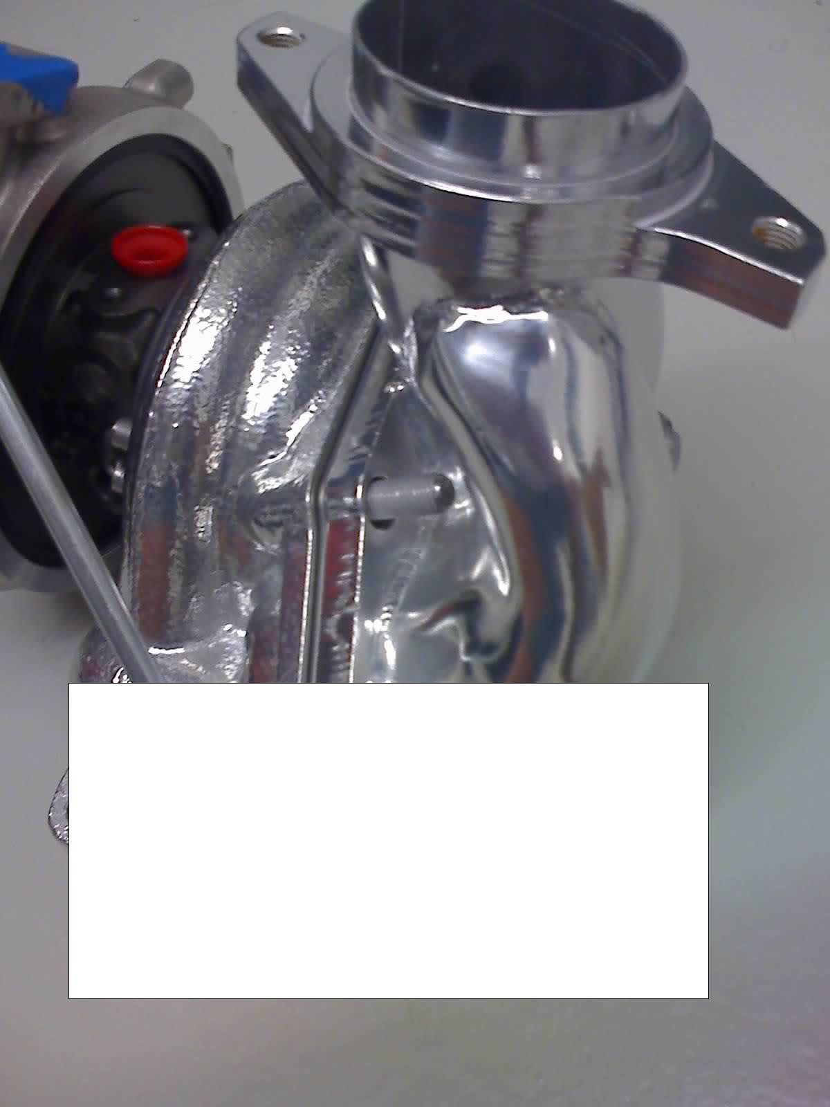

Here are some picts of Buschur parts, FP Green with hotside mods, exhaust manifold, and o2.
Attached Thumbnails Looking to move into fp green territory?-20-060.jpg   Looking to move into fp green territory?-20-059.jpg   Looking to move into fp green territory?-20-057.jpg   Looking to move into fp green territory?-20-058.jpg
