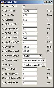

Here is a picture of the settings in AEM. Notice Alt_OK_below_VSS that is used to limit your anti lag settings to a speed (i.e. below 10mph). I am pretty sure it can be used for launching.
Where with using it for between shifts you would probably use the throttle posistion and rpm value instead.
