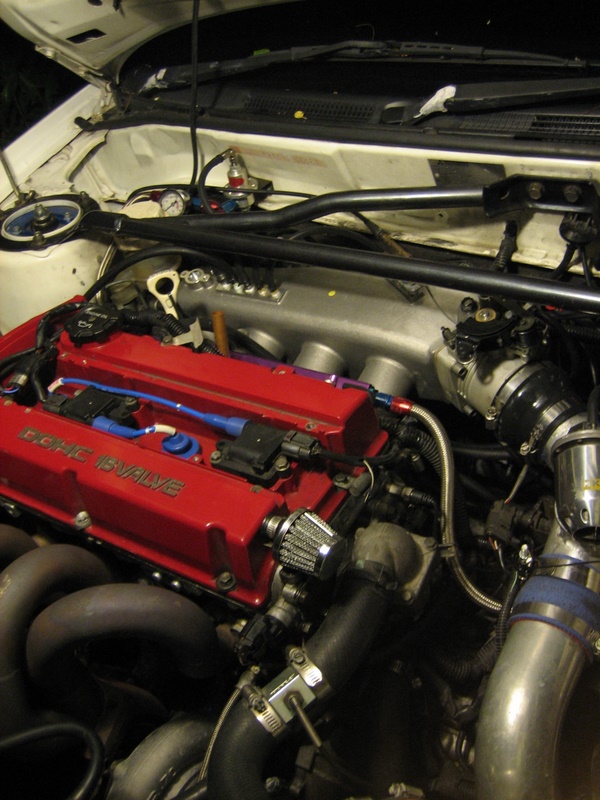

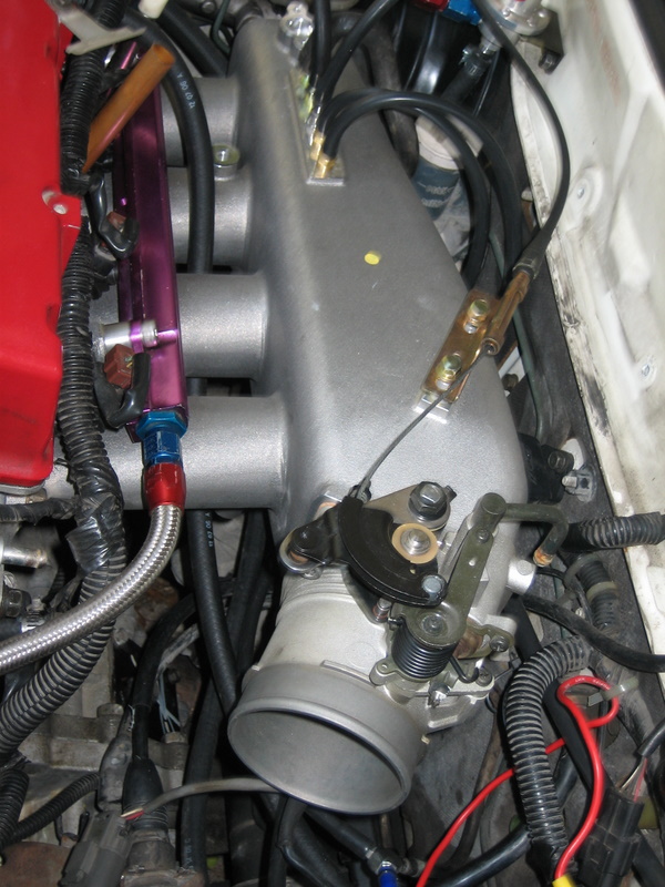

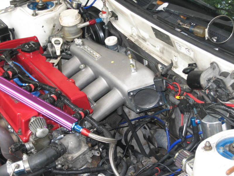

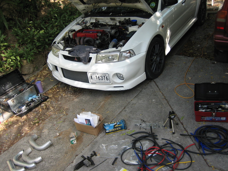

Installed and running! Thanks everyone for their help in the "effect on tuning" thread. It made me more confident adjusting the tune by understanding the theory behind things a little bit better. The new setup ran about a half point leaner on boost across the range, except for maybe after 7k. I was too focused on what I was doing to save a log, but I can load the previous map and do a pull if anyone must see.
The first pull on boost it picked up just a single tick of det, because it was a half point lean or so (target AFR is 12:1). I fixed the fueling and the det went away. I then bumped up the ignition by two degrees on boost and still no det. This told me my safety margin was still there. This was at night so I want to go out in the middle of a hot day and play with the ignition a bit more.
Here is some pics... deffo not a show car but it is working well. Car is idling well even with no IAC and the stepper motor controls disabled in my Autronic.

Man look how long those runners are!! i love it...with multiple vaccum sources
