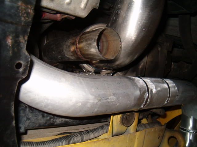

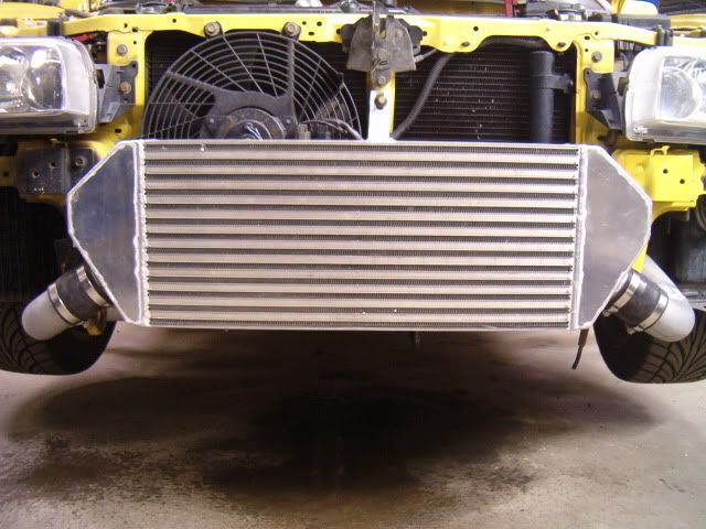

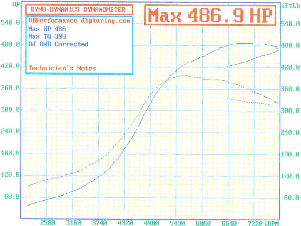

TIAL 30R Setup
Build Specs:
-SLS (TIAL 3076R/.63 AR) turbo kit
-SLS 24x10x3.5 FMIC
-FIC 750cc injectors/walbro pump
-Stock longblock
-AEM EMS tuned by DB Performance

Nice #'s (they are converted to DJ #'s correct?)
We have a car in the shop that will have a similar set-up but on stock ecu and Shearer manifold.
I'll post up the #'s but they will be done on a MD.
What fuel you tuning on?
Congrats

Yes, they are corrected Dynojet #'s. Tuning was done on 110 octane w/ peak boost of 30 psi.

By the way what were the un-adjusted #'s off the DynoDynamics dyno? There is one locally to us that reads close to our MD.
