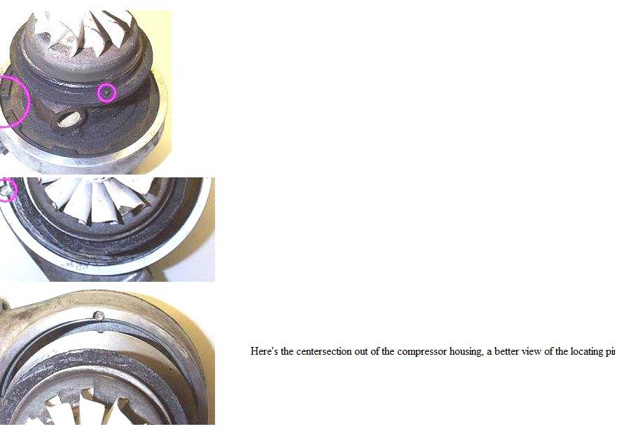

"Clocking" just means rotating the compressor housing so that the outlet is pointing in the direction you want. Our stock turbos have a little pin on the center section and a hole in the turbine housing to line up. No need to worry. Here's some pictures from a dsm 16g. It's the same idea;

The locator pin can be seen in this photo. It's at the top of the machined surface, about 11:00 o'clock. This pins "Locates the hotside to the center section. I tested several 'clocking' settings, mostly to give better clearance in the 'Compressor Outlet to Starter' area. Even the slightest 'clocking' will cause the oil drain to pan line not to match up, closer than expected clearances to the radiator fan and the oil drain from block to turbo not to match up. I did finally settle on very slight clocking which helped slightly on the Compressor outlet pipe to starter clearance. Hope that helps. It's easier to leave it as it is however.

In this picture, you can see the "Locating hole" in the center section. You can see it about 2:30 or 3:00 O'clock. Also, if you look closely, you can see the "locator" pin on the Hotside. It's about 7 or 8 O'clock.

Cool thanks for the pics, So when re-installing the hot side I just slap it on making sure I put it in the same location and I don't have to clock it?

When you reinstall the hotside just make sure the pin lines up with the hole.
