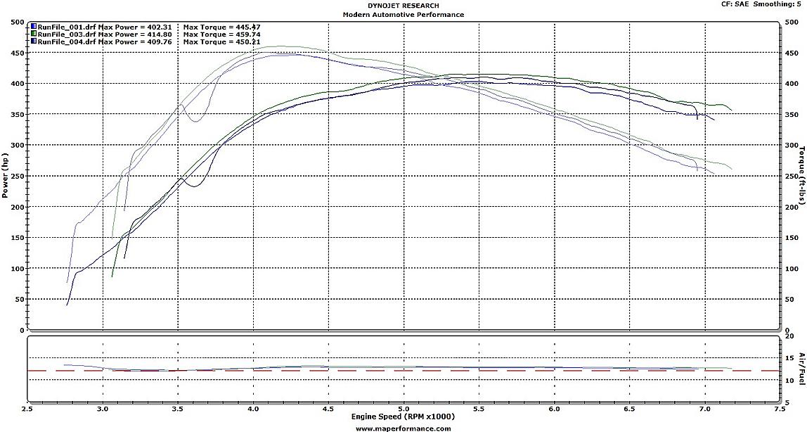

E85 I run it in my eclipse gsx and I have 321hp 347tq with a evo316g and walbro255 and 680cc injectors, and 3" exhaust and arp studs that's about all i have done with a little more I would be around 400hp. My cousin also runs it in his car he has 414hp 459tq he has about the same setup plus cams and a fmic. With a good tune you will really love E85
Old Feb 7, 2009 | 12:03 PM
Nightjoker7's Avatar
Joined: Jan 2009
Posts: 40
From: Spicer MN
I forgot to post this, its my dyno chart on E85 I know its not a evo but it is a good example, and yes I do have a evo also I just haven't modded it yet.
