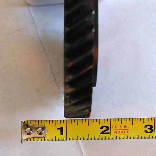

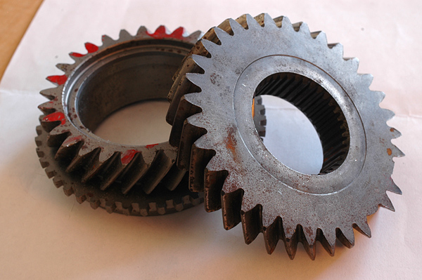

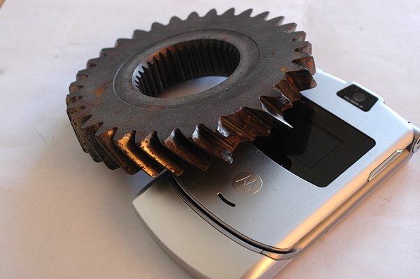

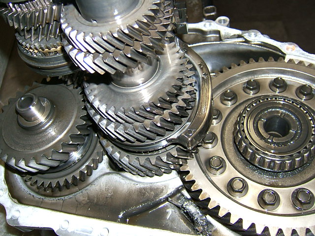

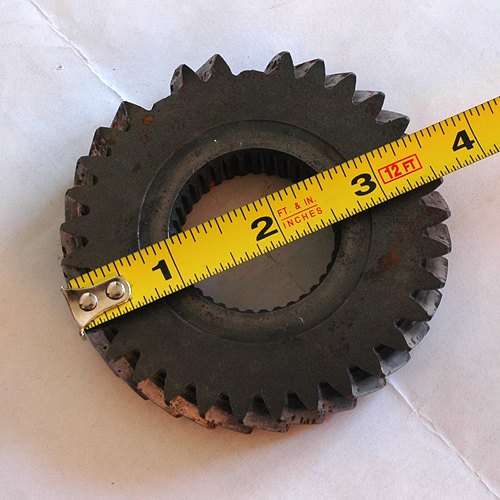

So I got the trans apart today to inspect.. So far it looks like there was no damage other then the 4th gear input shaft and main shaft for the 4th gear.. Everything else looks to be in very good shape with close to zero marring or nicking on any other gears, they almost look brand new..
So judging by the pictures, and lack of any type of discoloration to the gears themselves, I am leaning towards the failure being touque related, but I would like to hear some opinions on this as well..
I am definitely going to be swapping over to a 5 speed but I am also going to rebuild this trans with new gears 4-6 cryo treated and shot peened since it seems like an excellent candidate for a rebuild. The synchro's worked flawlessly before this failure and it has about 40k on it.. Luckily I did not attempt to engage 4th gear after the failure and had the car towed immediately, the related synchros do not visibly show any signs of damage and seem to move smoothly as they should..
Well here are the pics.. BTW I would guess the car to be making about 475+ tq. on a dynojet at the wheels on a stock turbo at high boost..
BTW the gear on the main shaft took more of a beathing the the actual 4th gear on the input side.. Seems like a snowball effect to me.. Any experts wanna chime in on this? Last time I had a trans apart for a rebuild was close to 8 years ago on a DSM lol
FWIW: this failure happened after just cruising on the highway on the way home from the track, I slowed down, was in 4th cruising for a min or so, gave it some gas and it just let go..Certainly not sustained high rpm or anything like that.

Not as carnage filled as I expected. Considering the tq your making.

Atcually now that I am looking 4th and 5th does appear to have some discoloration lol..But the pics are not the best..I will have to double check this tommorow

looks just like my 4th gear failure although you ripped more teeth off then I did.

They do look quite similar, but since I broke more teeth my car is faster!
