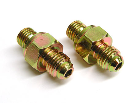

I'm looking to eliminate the banjo bolt that feeds the turbo from the head with a 90-degree fitting. The only problem is that I can't seem to find the right fitting and was wondering if anyone knows where i can order one at. The fitting would look similar to this, but would thread into the head and accept a -4AN oil line. I believe the threads for the oil feed into the head are 10mm x 1.25 pitch
Worst case I'll order one of these that is a straight fitting, but I prefer a 90-degree if possible:http://www.atpturbo.com/Merchant2/me..._Code=ATP-OIL1

ATP got back to me w/ a solution that will do what I'm looking for. They said to combine these two parts and I will be able to have a 90-degree for my oil feed. This may help somebody else looking to eliminate the banjo bolt w/ crush washers on their setup.
Combine this:http://www.atpturbo.com/Merchant2/me..._Code=ATP-OIL1
and this: http://www.atpturbo.com/Merchant2/me...egory_Code=BCS

if you can find out thread/pitch this may work
http://www.streettunedmotorsports.co...90_adaptor.htm

its a 10x1.25 call your local hose shop and they can get you everything for the best prices,. thats what i did or you can order the parts from someone like
http://www.maperformance.com/evo-vii...s-accessories/
