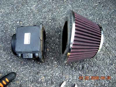

I recently purchased used evo9 which went through 2 previous owners. I'm trying to identify this intake filter so that I can purchase right cleaning kit.(Last owner has no idea)
There's no serial or brand mark on the filter or the pipe.
Also found this tubing(i'm holding it in the pic) right underneath the filter that was just hanging by this thingy...i tried googling serial# but no luck....
If anyone has any idea, i'd really appreciate it. (Pics below)

looks like a buschur filter.dont matter what brand just get k&n cleaning kit

That hose is off that solenoid directly beneath your hand in the pic. It's the stock boost control solenoid. If you're using some other sort of boost control...just route that hose onto the open barb on the solenoid to keep debris outta there in case you "go back to stock" ever.

Doesn't really matter what brand it is, just use a k&n filter cleaning kit.

just put a perrin filter on there and call it a day

Thanks for the replies! I think I'm going to go with Perrin turbo intake kit.
