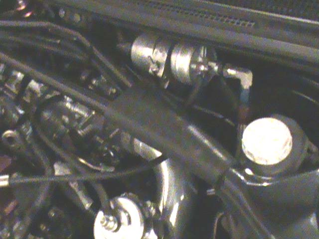

Any Pics ... ??
My Inline pump will be mounted this week end ... Im crossing my fingers ..

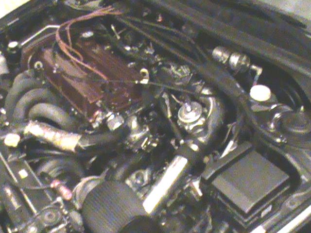

Here's a few pics
Attached Thumbnails installed bosch 044 inline pump, now problems-picture-005.jpg   installed bosch 044 inline pump, now problems-picture-006.jpg

From: underground
your pump looks bakwards
I set it up that way, because the lines fit better crisscrossing them, than trying to run them direct from that angle. They crisscross under the IC pipe. Of course if I had it on backwards there is no way I could push 530whp on E85
Old Jan 11, 2010 | 08:33 PM
Makes sense now...
