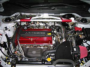

You'll want to install the battery first, since the positive cables will not have much play at all. In fact I did it the opposite of what they show in their pics. That required fabricating 1 new ground line, but I think it works out better. You can see how I did it in the pic. The red plastic terminal cover will need to be trimmed down with a Dremel to clip on properly, if you want to retain it.
Other thing is the L shaped 90 degree section of hose from bov to mass air pipe they provide might have to be cut to fit. The factory hose is a larger diameter, so it can not be used in place. To remedy this I cut down the short section of the L so that the stub on the MAP stuck up into the elbow, and then I used a third wide T-bolt clamp at the 90 to keep it open. Without the clamp, it looked like it was starting to kink. *EDIT* See below post for further explanation.
Instead of all the sections of hard/flex tubing going from intake manifold to bov, I ran one section of Aeroquip braided stainless, which cleans it up a little, and eliminates a whole bunch of clamped fittings.

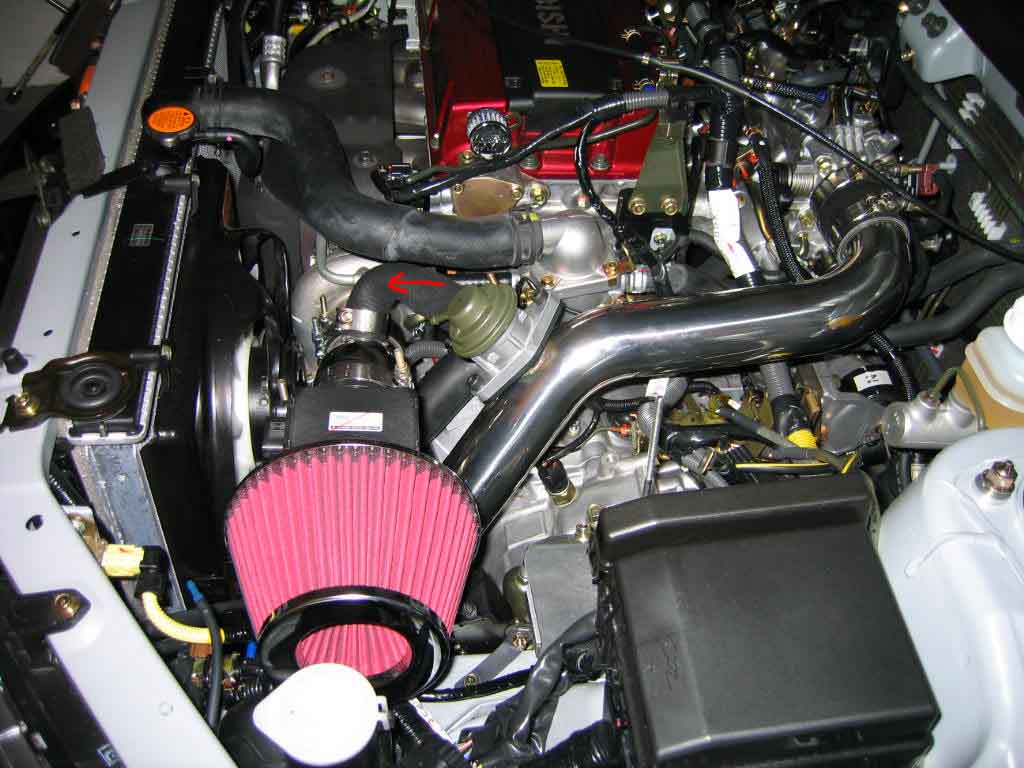

Better pic showing kink in neck (red arrow). This was with the hose cut down somewhat. After I cut it down further, and added the clamp to that area, it is fine. This was also before I removed all of the lines from intake to BOV, so they are still visible, although this was the first iteration, where I had replaced all the factory lines with thick wall silicone lines covered with black flex sheathing, hence the blue visible.

Looks like im not the only one with bov tube problems! Its even harder without having the bov fastened to the top of the ic pipe. Mine makes this terrible noise from being kinked.

If the line had the same shape as the stock piece, which is more of a gooseneck, it would be perfect. I have a call into a industrial supply shop here in town, trying to get a silicone hose formed to correct dimensions. Not exactly a big job, so I am low an priority list, but it really bugs me having it rigged with a T-bolt clamp as a kink eliminator.
ou may be able to find a 1" or whatever piece of pipe and have it bent to you need at a muffler shop and just use a couple of small joint hoses to get it in there.
The hose on our car fits perfectly. From what I can see in the pictures the hoses need to just be trimmed shorter to get rid of the kink.
This is the closest fit we could find and if it is cut to length it fits perfectly.

Alrighty, funny thing that I just saw this post and the one about the MAS pipe.
Hammerli, Phil, that was good enough to post the pictures above just happens to be at our shop right now. I saw the hose and the clamp on his car and asked what the deal was with it. I was going to offer to fix it but didn't want to seem pushy. After reading 5stars remarks I went out and asked if he minded me having a shot at getting the hose to fit right. He said he had no problem with it.
All I ended up doing was cutting the BOV return hose that we supply with the kit about 3/4" shorter. I also had to loosen the clamps to the turbo/MAS end and slightly rotate the MAS pipe, maybe 3-4 degrees. The hose now fits perfectly without a kink in it just like it does on our car.
I guess what I am getting at is in order to build a part that flows perfectly and eliminates as many bends as we did on the i/c pipe sometimes you might have to do a little adjustment to get it in. There aren't marks on it to let you know exactly where to turn it, you basically have to play with it a little. It is part of building/modifying your car.
I hope this helps you guys see that the parts are correctly built, just sometimes need a few more minutes of looking at them and seeing what it would take to make it just how you want it.

I AM A F'ING MORON!
I HAD THE BOV FACING THE WRONG DIRECTION!
The funny sound was not due to my kink, but my stupidity!
I reversed the two and it fit MUCH easier. I got the kink out by cutting allittle tubing off. (I had it working the first time but wanted to add allittle length to the tubing and clean it up; so I replaced it with a tube too long and put the bov on backwards!)
Hope I didn't f'k anything up!
Anyhow, props to David Buschur for the openess on the support. And I WILL be buying his intercooler kit as soon as I get the money!
