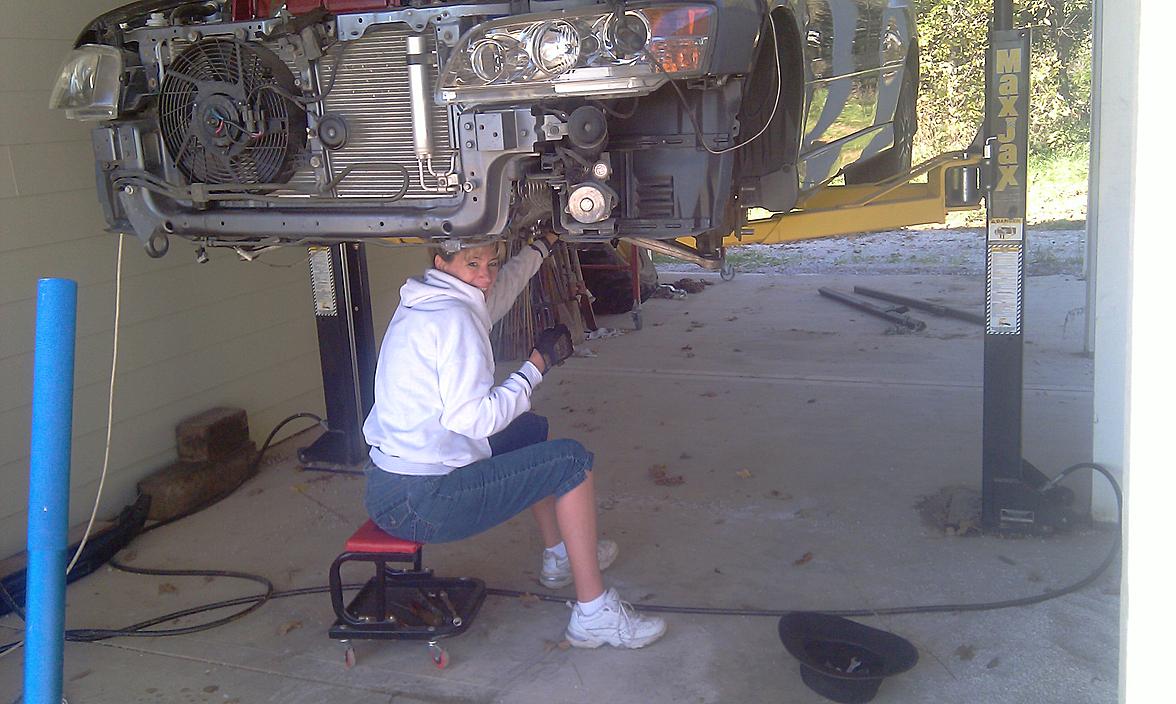

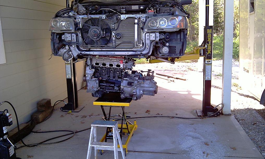

I bought one of these
http://www.maxjaxusa.com/
and it makes engine removal out the bottom so easy. Only $2K !

Advice Needed: Engine Removal-evo1.jpg
Advice Needed: Engine Removal-evo2.jpg
Is that cool ?? So easy my girlfriend can do the swap !!

really thinking about buying that lift ...is it quality?

Does that bolt to the ground somehow?
