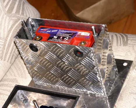

gets it started every time with an ems even...
http://cgi.ebay.com/ebaymotors/ws/eB...category=35594
