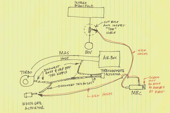

and here is a good diagram, if you need to hook up MBC (manual boost controller) who allready did in hand
it works.
