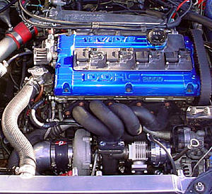

If this system is anything like what Buschur has been offering in the DSM community for a few years now. You guys wont be disappointed. If you are having ignition issues this will definitely solve it.
Also as Tym explained it will be Plug N Play. I have their dsm version and love it. It just gives you a Piece of mind when you can look at one of the Buschurs race cars and see the exact same parts you have on your very own street car. Remember Buschur started 4g63 tuning in the U.S 15 years ago. They know what works and whats BULL****
