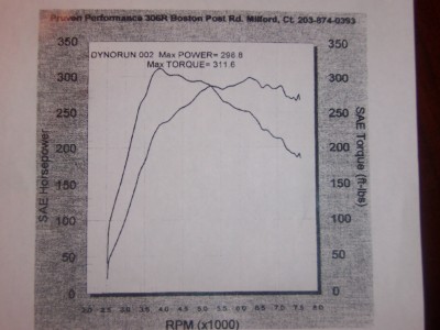

IMHO - you are looking for broad, flat trq curves and no dips in the chart with a rich a/f
Here is a sheet I am very proud of - its a safc vs. my dyno flash - a nice low end grunt on a very conservative tune

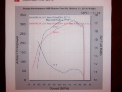

here is a stock cam car with the Buschur Stage 2 - again - super low end power which I pride my tunes on and a real safe tune you can run on pump gas every day with no sweat
