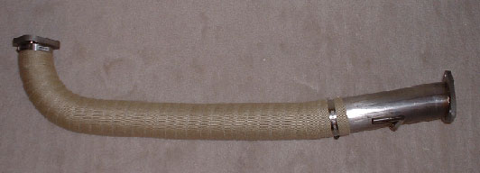

My AMS downpipe and high flow cat arrived on Tuesday and both were installed the same night. Here are my observations so far:
The first thing I noticed was that the packaging was superb. The items were packed very thoughtfully and were properly “cushioned.” Now, I wouldn’t normally pay much attention to it to write about it, but after my recent experience with another vendor (cough, cough), where the items were basically thrown in into the box and shipped, I thought I would give credit to AMS for it.

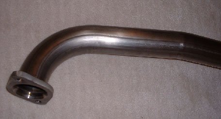

The first thing I noticed about the DP when I took it out of the box is how “straight” it is. I don’t thing you can design anything less restrictive than this piece. Also the workmanship is amazing. Mandrel bent, TIG welded (see pics below). Comparing it to some of the other downpipes I have seen, this thing is a piece of art
The installation was smooth and took about 30-45mins. I wrapped the pipe with some thermal wrap to keep the heat away from the oil pan as well as to keep the velocity of the gases up. There were no issues with fitment. The downpipe uses the stock gasket on the 02 sensor housing side. The cat (catco) comes with a welded-on extension that replaces the tapered 6” adapter section, which comes with their cat-back. So for those that have the AMS catback, you now have a true full 3” exhaust.
My only 2 setbacks with the downpipe were:
1. The bolts that came with the DP had one nut that was of a different size, therefore unusable. Thankfully I had one that fit and so it wasn’t a big deal.
2. The bigger disappointment was that the DP didn’t clear EITHER one of the lower tie braces. It’s not even close. I hope that I can replace it with some aftermarket ones, but for now I had to take both of these off. I guess that is the price for such a straight design.

I'd rather have a downpipe with less bends and use new tie bars then compromise on the downpipe to clear the stock tie bars anyway. If AMS can come up with a solution that doesn't cost significantly more then other downpipes, then I'll get one for sure.
the rear brace can be saved by adding two to three washers or spacers. the Front is a loss but we are working on some sort of a sollutuin. Glad you liked the Piece Wojo.

Originally posted by Diesel
nice review man...
what kinda wrap did you use, and where did you get it...?
nice review man...
The wrap I used is called Exhaust Insulating Wrap by Thermo Tec. I picked one roll from SummitRacing.com for under $40. I went with the 2" x 50ft size. Here's the manufacturer's website www.thermotec.com
