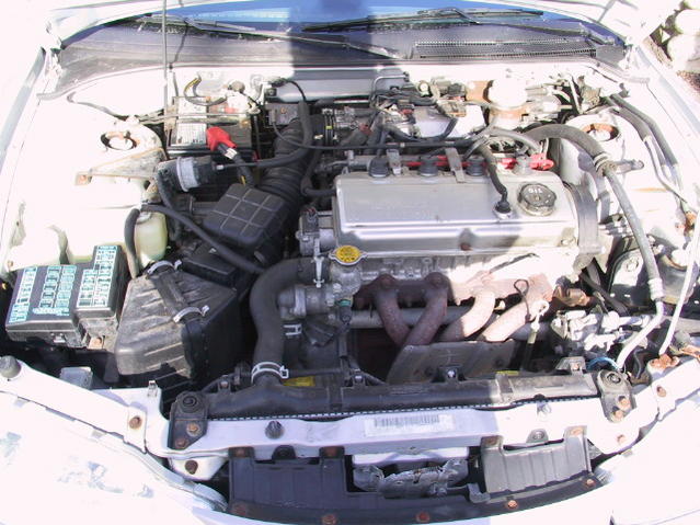

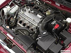

1999 and up Galant,and 2000 and up eclipse 2.4 should work,earlier 2.4s were on the left side of the car therefore making it impossible to attach other important stuff to the engine like alternator and a/c compressor,if they were installed on the right side of the car as in an Evo,since they would be in opposites sides then.Hope this info can help.
Attached Thumbnails 2.4 block help-0400-050-engine-480.jpg   2.4 block help-oldengine.jpg
